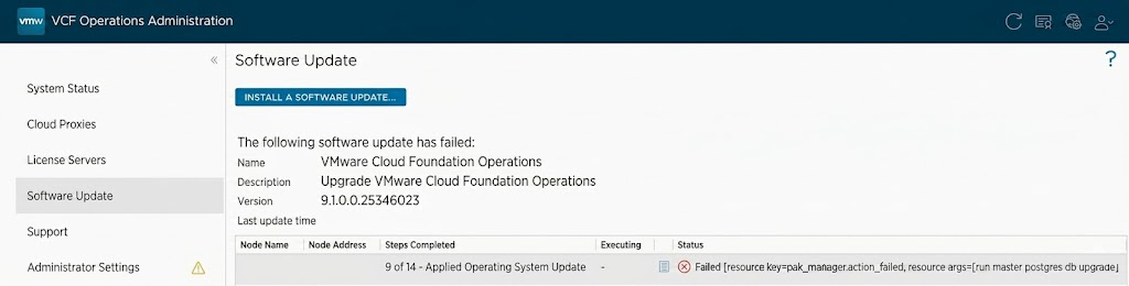

To determine if this KB applies for the VCF Operations 9.1 upgrade failure:
  1. Log in to the VCF Operations Admin UI and navigate to the Software Update tab
    1. Validate the Steps Completed column for the primary node displays "9 of 14 - Applied Operating System Update"
    2. Validate that the Status column for the primary node displays "Failed resource key=pak_manager.action_failed, resource args=[run master postgres db upgrade]"
