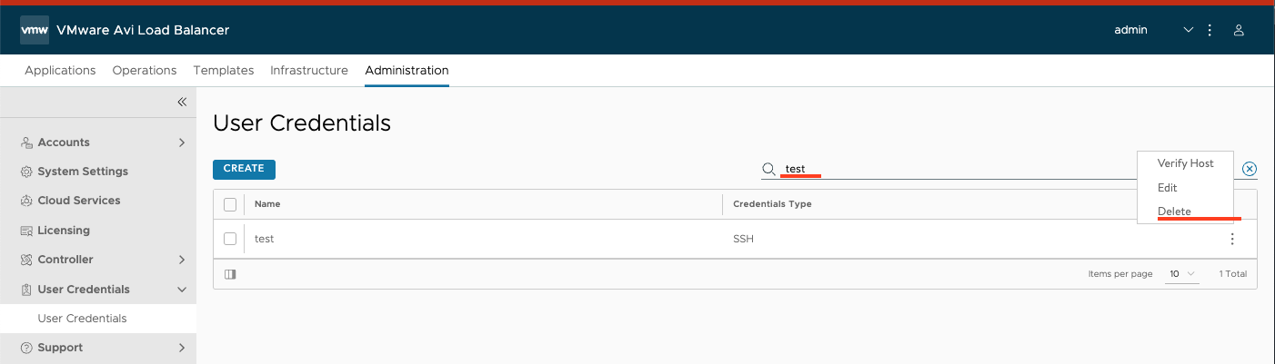

  4. On the controller GUI.
  5. Go to Administration ==> User Credentials ==> User Credentials ==> Search the user.
  6. Select the user and delete.
  7. Retry the upgrade.
