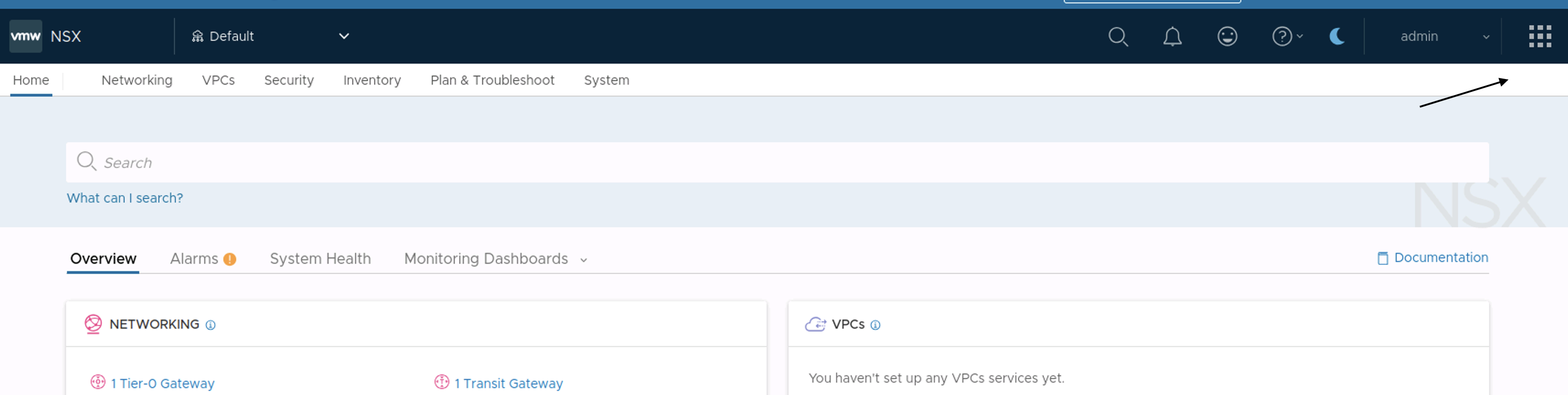

A successful onboarding returns:
status: DEACTIVATE_PROVIDER
The same state can also be verified from the NSX App Switcher UI. This confirms the onboarding workflow has completed and the Avi provider is registered with NSX Manager.
