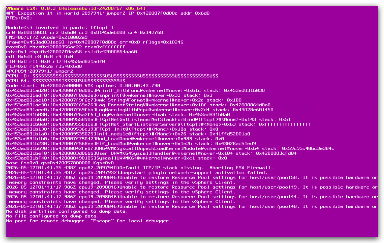

  • An ESXi 8.0.x host fails to boot and experiences a Purple Screen of Death (PSOD).
  • The PSOD screen indicates a Page Fault exception related to the Fault Tolerance network module: #PF Exception 14 in world [ID]: jumper2 IP [Address] addr [Address] Module(s) involved in panic: [ftcpt]
  • The PSOD backtrace shows the crash occurring during network initialization: FTCptNetGetListenerNetStackForBind FTCpt_Init
  • At the bottom of the PSOD screen or in the console logs prior to the crash, the following error messages are observed: Unable to restore Resource Pool settings for host/user/pool[ID]. It is possible hardware or memory constraints have changed. Please verify settings in the vSphere Client. Default TCP/IP stack missing. Aborting ESX Firewall. Jumpstart plugin network-support activation failed.
