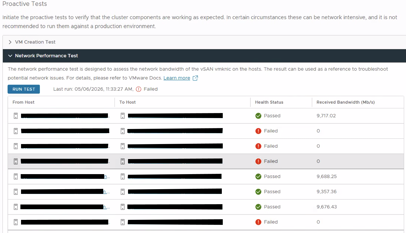

  • Proactive network performance tests show inconsistent failures across multiple hosts.
