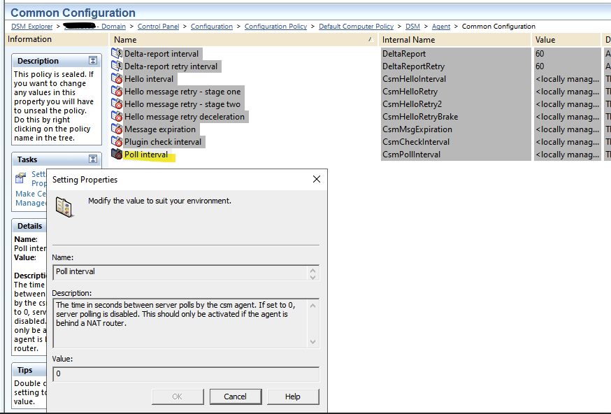

Based on this, there is a configuration policy applied to some Agents which set the polling every 5 minutes, causing that the Scalability Server os overflowed by messages, causing that OSIM jobs are not being updated correctly due to this long queue.
The suggestion is to set the policy “Poll Interval” to 0 and apply it to all Agents. The policy can be found under:
DSM -> Agent ->  Common Configuration
