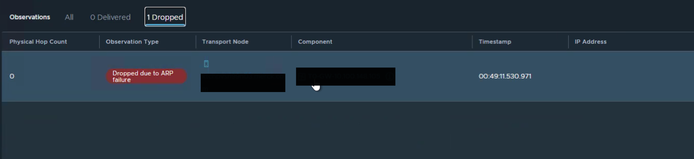

  • North-South traffic from VMs on NSX logical segments is failing to reach the Tier-0 (T0) router.
  • Traceflow analysis indicates that packets are "Dropped due to ARP failure" before reaching the transit-bp interface on the NSX Edge node.
