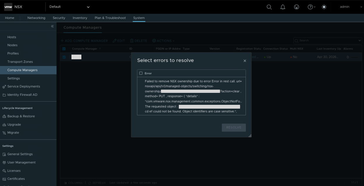

  • In the NSX Manager UI, under [System] > [Fabric] > [Compute Manager], a Registration Error is displayed, and the following message can be observed.
    Failed to remove NSX ownership due to error Error in rest call. url= nsxapi/api//v1/managed-objects/switching/nsx-ownership/<CM_UUID>?action=clear , method= PUT , response= {  "details" : "com.vmware.nsx.management.common.exceptions.ObjectNotFoundException: The requested object : <DVS_ID> could not be found. Object identifiers are case sensitive.",  "httpStatus" : "BAD_REQUEST",  "error_code" : 8012,  "module_name" : "NsxSwitching service",  "error_message" : "Unable to clear NSX ownership from MO <CM_UUID>/<DVS_ID>."} , error= 400 : "{  "details" : "com.vmware.nsx.management.common.exceptions.ObjectNotFoundException: The requested object : <DVS_ID> could not be found. Object identifiers are case sensitive.",  "httpStatus" : "BAD_REQUEST",  "error_code" : 8012,  "module_name" : "NsxSwitching service",  "error_message" : "Unable to clear NSX ownership from MO <CM_UUID>/<DVS_ID>."}"

  • The DVS with the ID mentioned in the message is not being used in the NSX Transport Node Profile and no longer exists on the vCenter side.
VMware NSX
This issue occurs because stale information regarding a previously used DVS persists within the NSX Manager's internal records.
On the error screen visible in the NSX Manager UI, select the checkbox next to the error message and click the Resolve button. If the provided steps do not resolve the issue, contact Broadcom Support for further assistance.
