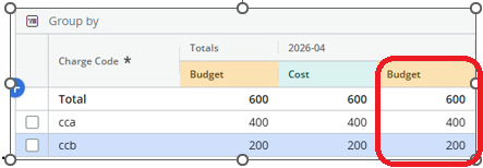

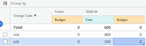

  3. In MUX create a project and financially enable it.
  4. Financials tab > Cost Plans > Create a Cost Plan with Charge Code as Grouping Attribute for example
  5. Add the Budget per period metric to the view
  6. Add two rows and add some cost to each
  7. Submit it for Approval
  8. Financials tab > Budget Plans > Right click on the Budget and Approve it

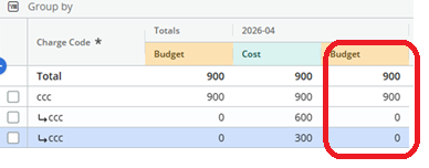

  9. Go back to the Cost Plan and look at the plan, Budget data is populated for each row and the total

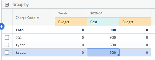

  10. Financials tab > Cost Plans > Create a Cost Plan with Charge Code as Grouping Attribute for example
  11. Add a single row to the plan
  12. Right click on the row and "Create Detail Row". Create a couple of detail rows
  13. Add some Cost to the Detail rows
  14. Make the plan as POR and Submit it for Approval

Expected Results: The Cost Plan rows to show Budget data against them
Actual results: Only the parent row shows an aggregated value
