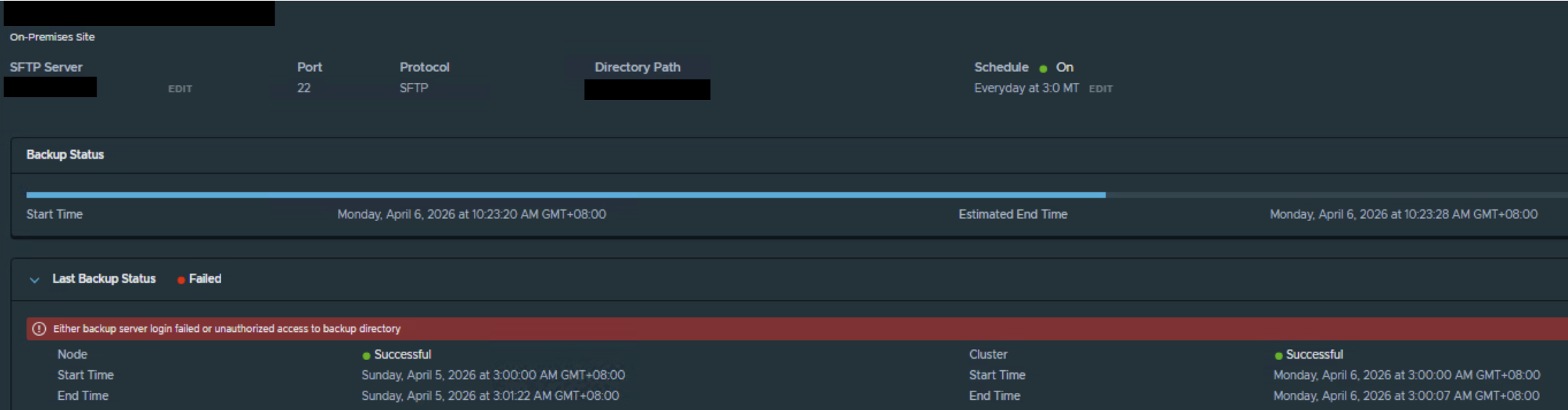

  • Last Backup Status shows "Failed", however node and cluster Backup status is Successful.
  • Manual Backup completes successfully.
  • In nsxapi logs we see error code similar to the below observed:
    Log Location on manager: /var/log/proton/nsxapi.log
    [nsx@ comp="global-manager" errorCode="MP29115" level="ERROR" s2comp="backup-restore" subcomp="global-manager"] Cluster backup failed with ; BackupAsyncStatus [BackupStatus [status=AUTH_FAILURE, statusDetail=Cannot connect to sftp server. The remote server returned error: status: 255   out: '[Errno 5] Input/output error'.
  • SSHD logs collected from the Windows SFTP server indicates that connection between NSX manager and the SFTP server was closed due to MAXStartups.
