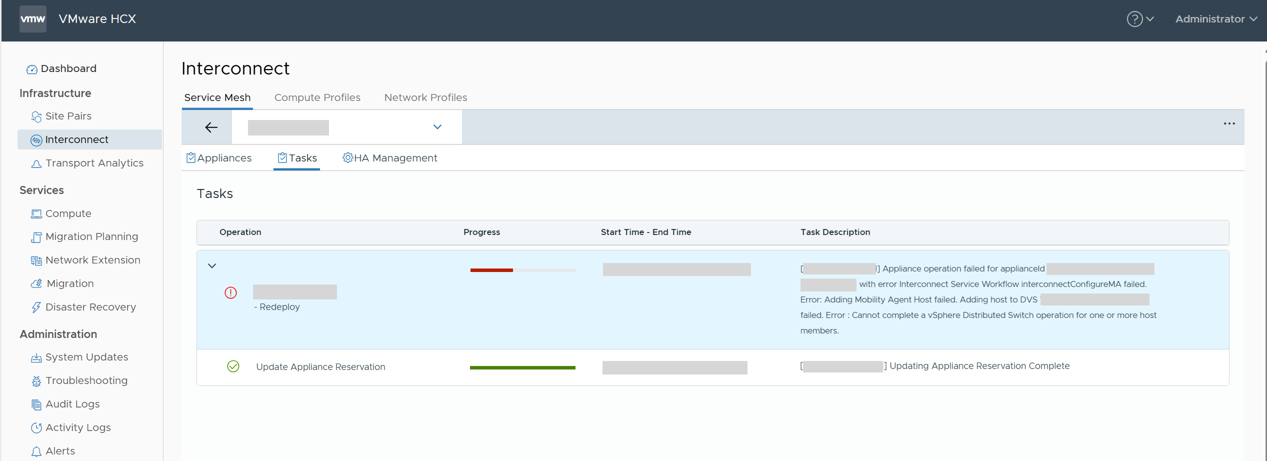

  • It is observed from the HCX Manager UI that the IX appliance (Inter-Connect) re-deployment task fails with the following message:
    Appliance operation failed for applianceId <UUID> with error Interconnect Service Workflow interconnectConfigureMA failed. Error: Adding Mobility Agent Host failed. Adding host to DVS <DVS_name> failed. Error : Cannot complete a vSphere Distributed Switch operation for one or more host members.
