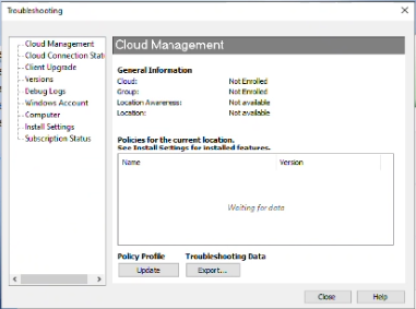

After opening the SEP client interface and clicking Help and Troubleshooting the following is observed:
- Cloud Management:
Cloud: Not Enrolled
Group: Not Enrolled
Policies for the current location.
"Waiting for data"

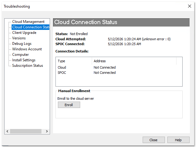

- Cloud Connection Status: "Not Enrolled" similar to the screenshot below:
