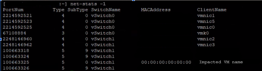

  • Running the net-stats -l command on the ESXi host indicates the virtual machine is reporting 00:00:00:00:00:00 for its MAC address.

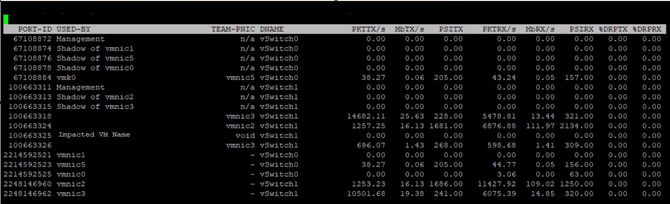

  • The esxtop network view demonstrates the virtual machine is not mapped to an uplink, displaying as "void" in the output.

net-stats on ESXi shows VM's MAC address as 00:00:00:00:00:00
