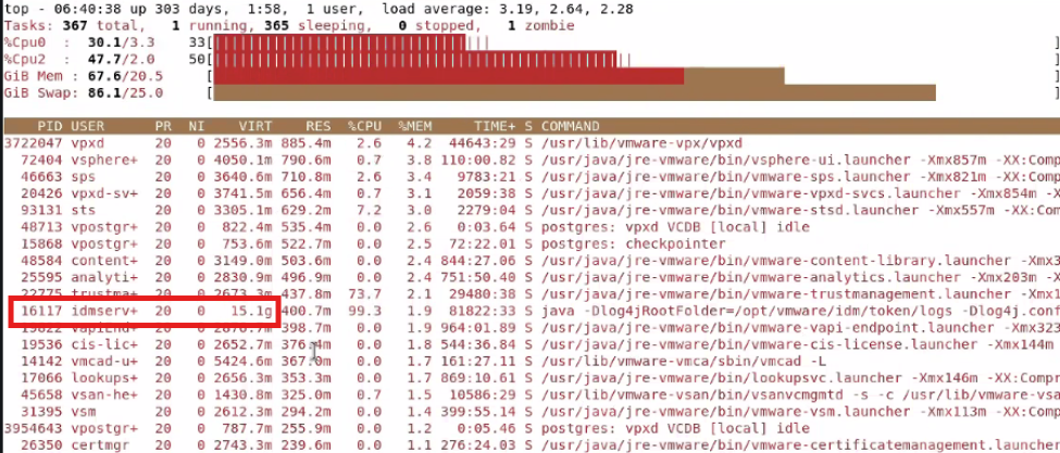

  • The top command indicates the idmserver process is consuming high memory:
  • Virtual Memory Size (VSZ), the process reserves very high virtual address space. While this number is alarmingly high, the actual physical memory (RSS) used is very low. (VSZ and RSS can be retrieved from var/log/vmware/procstate
    • For example:
    • | PID      | User         | CPU    | VSZ        | RSS        | Service
      | 16183    | idmserv+     | 47.2%  | 17.44 GB   | 0.45 GB    | accesscontrol (IDM)
  • The massive VSZ is likely an artifact of modern Java 17+ memory allocation on Linux.
  • Bash script analysis of /proc/smaps confirms high SWAP usage attributed to the java process associated with idmserver.

      11741504 16117    java
