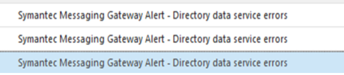

Symantec Messaging Gateway administrators may receive alerts or observe errors related to the Directory Data Service as below:
