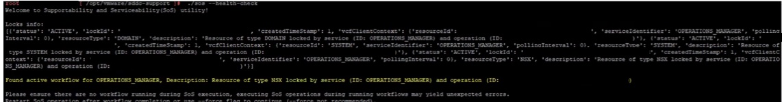

  • Running the command /opt/vmware/sddc-support/sos --health-check on the SDDC Manager appliance fails with an error indicating there are active locks for OPERATIONS_MANAGER.
