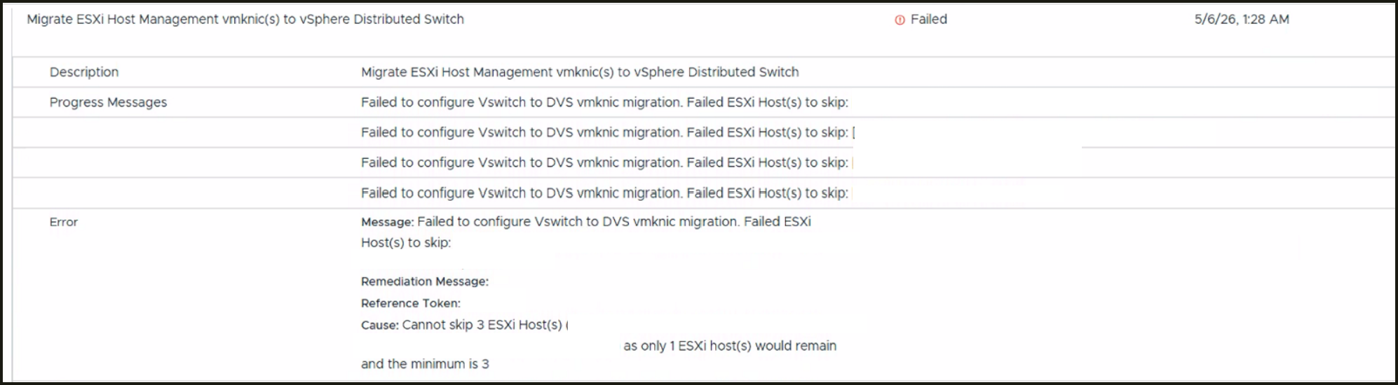

Unable to complete the vSAN ESA cluster deployment with error via SDDC Manager with Error : "Failed to configure vswitch to DVS vmknic migration on host"
Article ID: 439466
VMware vSAN
  •  vSAN ESA cluster deployment via SDDC Manager fails during the migration phase of management network from vSS to vDS.
VMware Cloud Foundation 5.x
VMware vSphere ESXi 8.x
VMware vSAN (All versions)
This issue occurs when there is a task in SDDC manager during deployment workflow which is trying to remove a NIC from a vSS,  if the remaining NICs on the vSS aren't able to pass the management traffic again impacting host's connectivity to vCenter.
This is a known issue and expected behaviour, If all uplinks from the vSS are trying to be moved to a vDS at the same time and the management vmkernel interface (vmk0) is not moved.
Manually migrate the ESXi host networking to bypass the SDDC Manager automation failure and correct the out-of-sync configuration.
  • Manually Migrate Management Network: In the vCenter UI, navigate to the affected host > Configure > Virtual Switches and manually migrate the management vmkernel adapter (vmk0) from the Standard Switch to the vSphere Distributed Switch (VDS).
