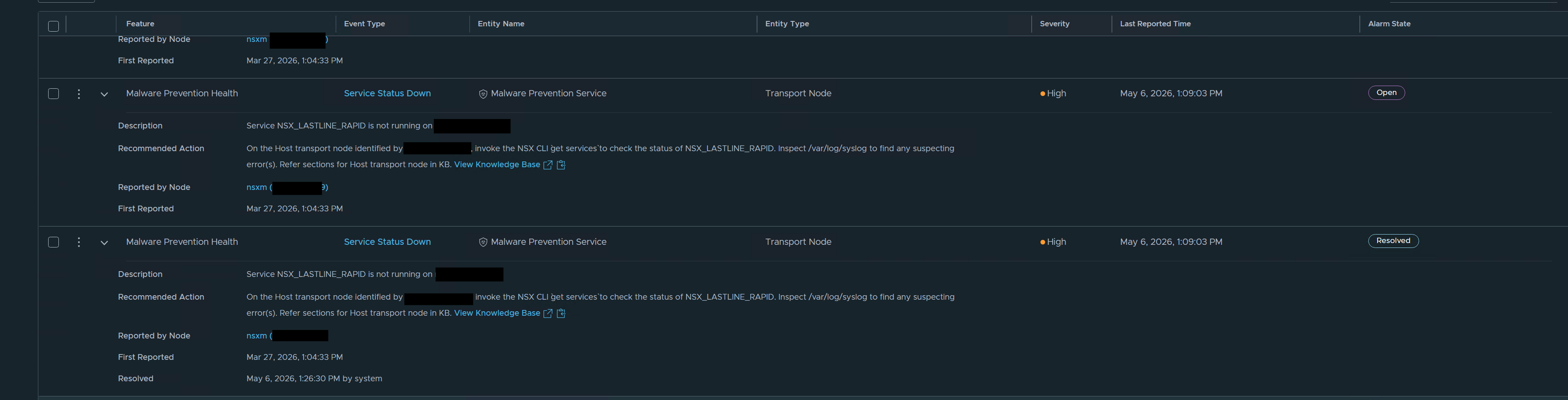

  • NSX alarm: Malware Prevention Health — Service Status Down High on one or more transport nodes.
  • Alarm persists after being manually resolved even if the deployment is successful.
