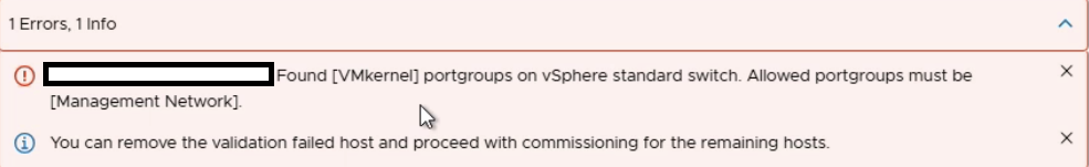

When attempting to commission a host in VMware Cloud Foundation (VCF) SDDC Manager, the validation task fails with the following error:
Found [VMkernel] portgroups on vSphere standard switch. Allowed portgroups must be [Management Network]
This issue specifically triggers during the host validation phase of the commissioning workflow.
