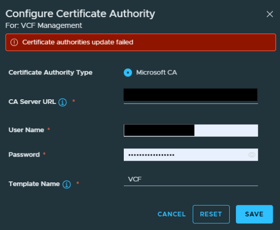

When you attempt to add a Microsoft CA server to VCF Operations for certificate automation, you encounter the following symptoms:
  • You receive "Certificate authorities update failed" error message in the user interface.
