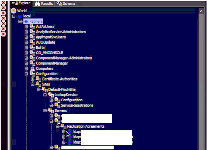

If the cmsso utility fails to remove the stale replication partner, utilize the jxplore utility to unregister the legacy node:

Click File > Connect and enter the following information:
Host:
<vCenter FQDN or IP Address>
Protocol:
LDAPv3
Port:
389 if using LDAP.
636 if using LDAPS.
Base DN:
dc=vsphere,dc=local
Level:
User + Password for LDAP.
SSL + User + Password if using LDAPS.
User DN:
cn=Administrator,cn=Users,dc=vsphere,dc=local
Note: vsphere.local is the default naming convention for the SSO domain. If the environment has an SSO domain different to vsphere.local, replace as appropriate.
Once connected go to > Configuration >Sites > Lookupservice> Servers > vCenter Name >Replication Agreements > Right click and remove the stale agreement.
