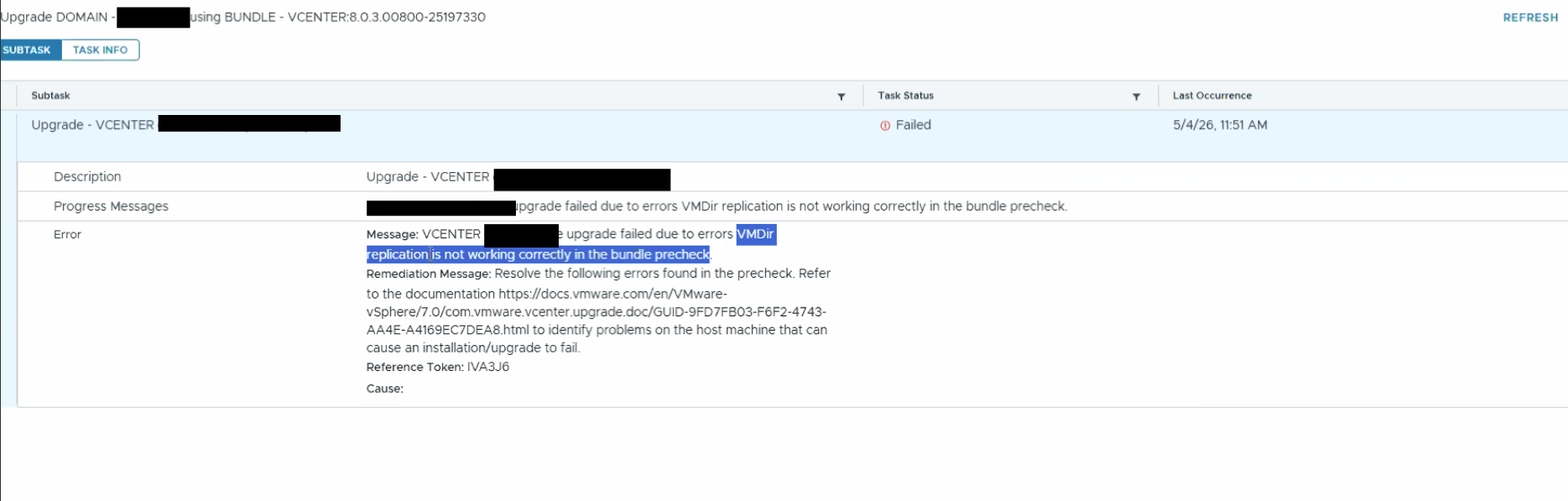

vCenter Server upgrade fails with VMDir replication is not working correctly during bundle precheck

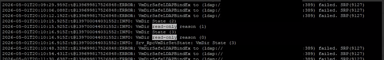

  • vCenter Server Preupgrade check result error:
  • Following /var/log/vmware/vmdird/vmdird-syslog.log there may be similar outputs

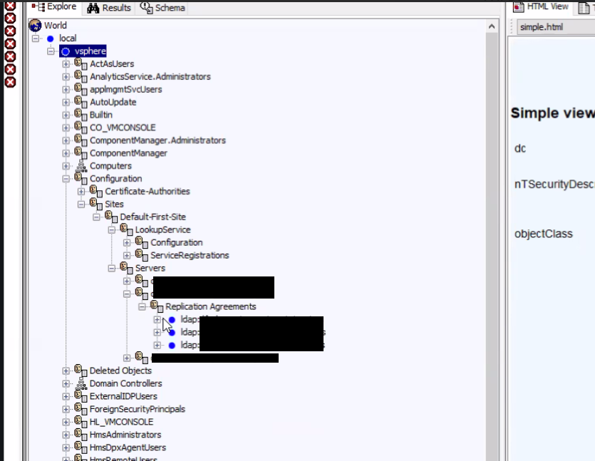

If the removeagreement is not removing completely, follow the workaround below to use Jxplorer to manually delete:
LDAP
  1. Download and install JXplorer from https://jxplorer.org/downloads/.
    Note: Java must be installed for JXplorer to function properly.
  2. Open the JXplorer utility.
  3. Click File > Connect and enter the following information:
    Host: vcenter.example.com
    Protocol: LDAPv3
    Port: 389
    Base DN: dc=vsphere,dc=local
    Level: User + Password
    User DN: cn=Administrator,cn=Users,dc=vsphere,dc=local
    Note: vsphere.local is the default naming convention for the SSO domain. If the environment has an SSO domain different to vsphere.local, replace as appropriate.
LDAPS
  3. Click File > Connect and enter the following information.
    Protocol: LDAPv3
    Port: 636
    Level: SSL + User + Password
Once connected go to > Configuration >Sites > Lookupservice> Servers > vCenter Name >Replication Agreements > Right click and remove the stale agreement
