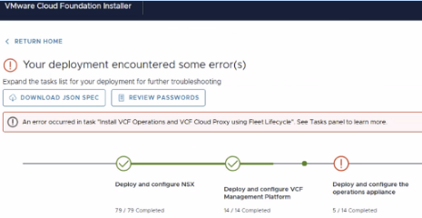

  • When deploying VMware Cloud Foundation (VCF) 9.1, the Management Services deployment task fails with VCF installer UI reporting the failure at "Install VCF Operations and VCF Cloud proxy using Fleet Lifecycle" even though the VCF Operations node(s) get deployed with an error similar to below:
    The Fleet lifecycle 'OVA component installation' task with ID <TASK_ID> failed. Internal errors: Failed to deploy VCF Operations node. Check vCenter tasks for errors., Status polling timed out. Review the logs to check operation progress. Increase the timeout value if the operation requires more time., Failed to deploy VCF Operations node. Check vCenter tasks for errors. REFERENCE TOKEN: <TOKEN>
