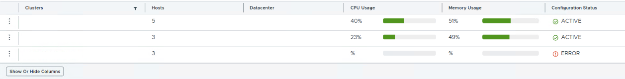

  • Following this failure, the cluster enters a stuck, failed, or inconsistent state. Standard management operations (such as expansion or workload deployment) are blocked.
  • The "Configuration Status" shows "ERROR" in the SDDC UI
