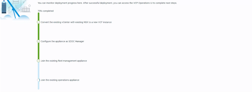

When attempting to import a new VMware Cloud Foundation (VCF) instance into an existing Fleet Manager, the task fails during the VCF Operations Collector OVF deployment phase, or gets stuck at "Updating join status of VCF Operations and deployment status of VCF Operations collector to succeeded".
