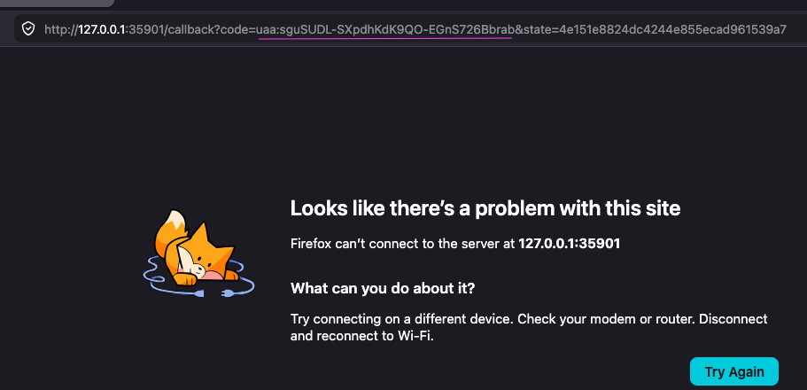

Then an error page might appear as illustrated by the following image.
Copy the code part in address bar including the prefix "uaa:". The code part that needs to be copied is also underlined in purple on the image below.
Past the copied code in "cf login" terminal and the login should succeed.
