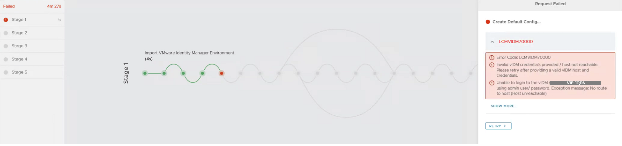

The following error is observed during the synchronization task:
Error Code: LCMVIDM70000
Invalid vIDM credentials provided / host not reachable.
Please retry after providing a valid vIDM host and
credentials.
Unable to login to the vIDM <vIDM VIP FQDN>
using admin user/ password. Exception message: No route
to host (Host unreachable)
