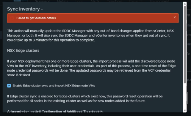

  • When attempting to sync inventory in VCF Operations for any Workload or Management domain by navigating to VCF Ops > Inventory > VCF instances , the task encounters below error and does not allow to proceed:
    Failed to get domain details.
