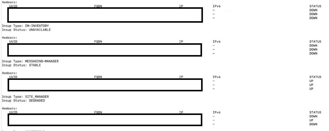

  • All three NSX Manager nodes are down and core services (Controller/Manager/Https) fail to start.
> get cluster status
  • The /config partition is at 51% utilization and growing, causing nodes to enter read-only mode.
  • The management cluster is stuck in DB Syncing and the UI is inaccessible.
