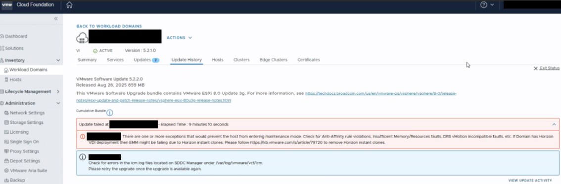

  • VMware Cloud Foundation (VCF) cluster upgrade from SDDC Manager fails during the precheck phase due to an ESXi host failing to enter maintenance mode with below error on the UI:
  • Upon reviewing the related task from the SDDC Manager UI, the below error message is encountered:
    Message: There are one or more exceptions that would prevent the host from entering maintenance mode. Check for Anti-Affinity rule violations, Insufficient Memory/Resources faults, DRS vMotion incompatible faults, etc. If Domain has Horizon VDI deployment then EMM might be failing due to Horizon instant clones. Please follow https://kb.vmware.com/s/article/79720 to remove Horizon instant clones.
    Remediation Message: Check for errors in the lcm log files located on SDDC Manager under /var/log/vmware/vcf/lcm. Please retry the upgrade once the upgrade is available again.
    Reference Token: <TOKEN>
