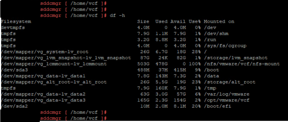

  • Checking the disk space on the sddc manager with the following command df -h shows full:

The filesystem hosting the UMDS patch store (typically an NFS mount or local directory at /nfs/vmware/vcf/nfs-mount/umds/patch-store) has exhausted its available disk space, preventing the download service from writing version metadata or new patch binaries.
  • Log in to the SDDC Manager appliance as vcf and switch to root.
  • Verify disk usage of the nfs-mount:
       du -sh /nfs/vmware/vcf/nfs-mount/* | sort -h
  • Identify and remove unnecessary items such as backups or older patch bundles to free space
