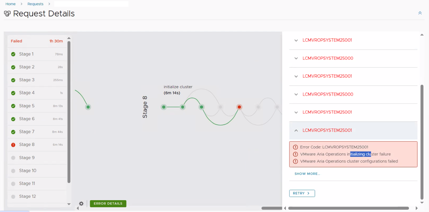

When deploying or expanding a VMware Aria Operations cluster using VMware Aria Suite Lifecycle (LCM), the request fails at the "Initializing Cluster" or "Cluster Configuration" stage.
  • Error Code: LCMVROPSYSTEM25001
  • Error Message: VMware Aria Operations initializing cluster failure. VMware Aria Operations cluster configurations failed.
  • The Aria Operations admin UI may show a status of "Failed" or remain stuck at "Waiting for Analytics."
