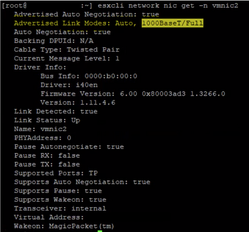

Method 1: Command Line Interface
  • Enable and log in to the ESXi Shell or SSH as root.
  • Identify the available physical adapters by running: esxcli network nic list
  • Check the specific capabilities of the NIC (e.g., vmnic2) by running: esxcli network nic get -n vmnic2
  • Locate the "Advertised Link Modes" line in the output.

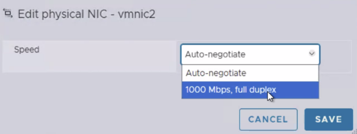

Method 2: vSphere Host Client (UI)
  1. Log in to the ESXi Host Client (https://<ESXi-IP>/ui).
  2. Navigate to Networking > Physical NICs.
  3. Select the target NIC and click Edit settings.
  4. Drop down the Speed menu to view available options.
Note: If a speed is not explicitly listed in this output, the NIC hardware does not support that speed.
