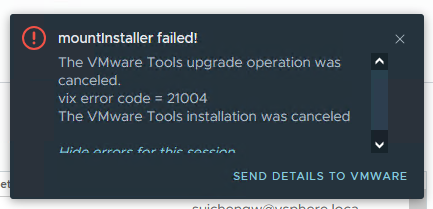

When attempting to install or upgrade VMware Tools from the vCenter vSphere Client:
  • Right-click VM → Guest OS → Install VMware Tools (or Upgrade VMware Tools)
The operation fails with the following error,
    mountInstaller failed!
    The VMware Tools upgrade operation was canceled.
    vix error code = 21004
    The VMware Tools installation was canceled
