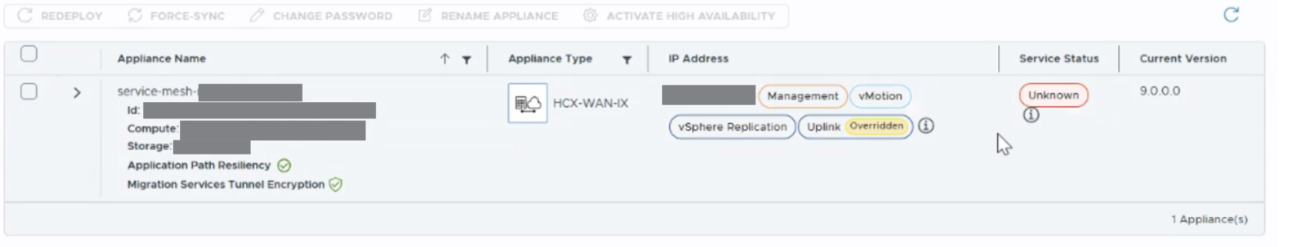

Following a redeployment of an HCX Interconnect (IX) appliance, the Service Mesh UI displays an "Unknown" status for the appliance. Specific indicators include:
  • Overall transport tunnel status: Unknown
  • Overall encryption tunnel status: Unknown
  • Service pipeline status: Unknown
  • However, the IX tunnel status from the target site showed as "Up".

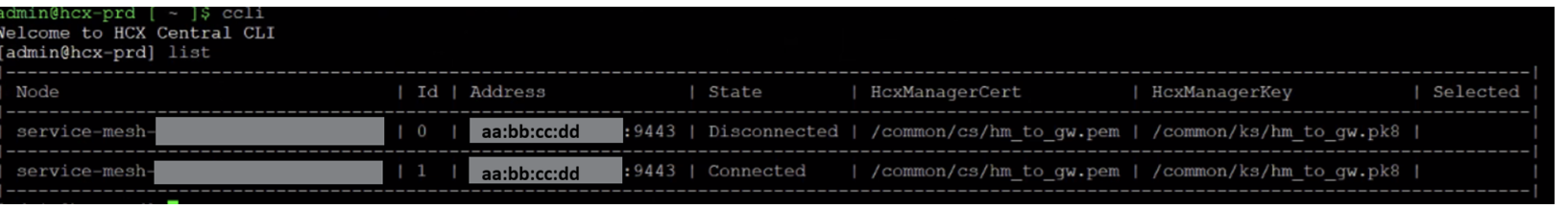

  • In affected environments, the ccli output reveals two IX appliances registered to the HCX Manager for the same site pairing:

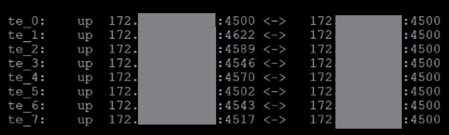

  • Although the transport tunnel may show as Up within ccli (via show transport status), the HCX Manager UI cannot reconcile the duplicate registration, leading to the "Unknown" state.
