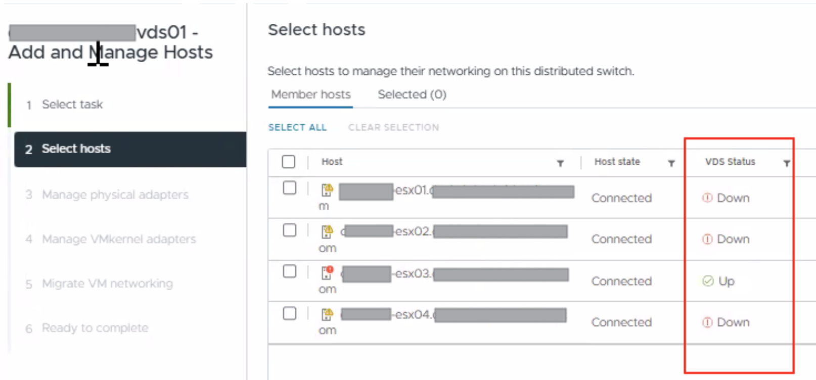

  • You may observe the Distributed Virtual Switch (DVS) status showing as "Down" when attempting to add or manage an ESXi host on the DVS. This issue can prevent proper network configuration and host connectivity through the DVS.
Unable to vMotion the VM's.
Below is the error message during VM migration
  • "Currently connected network interface" 'Network adapter #' uses network 'DVSwitch[<UUID>] NSX port group [<name>]', which is not accessible.
