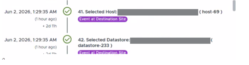

Note: Target ESXi host details can be located in the migration's Events view
