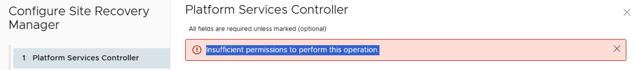

  • An error is observed during the configuration and integration of the vSphere Replication Appliance with the vCenter Server.
  • The following error is displayed during VRMS (vSphere Replication Management Server) registration:
ERROR
Operation Failed
A general system error occurred: Failed to register VRMS.
Operation ID: a23eada2-c301-4fdf-8fca-9585d157184f
  • When the registration is attempted using the SSO user [email protected], the operation fails with the message: "Insufficient permissions to perform this operation."

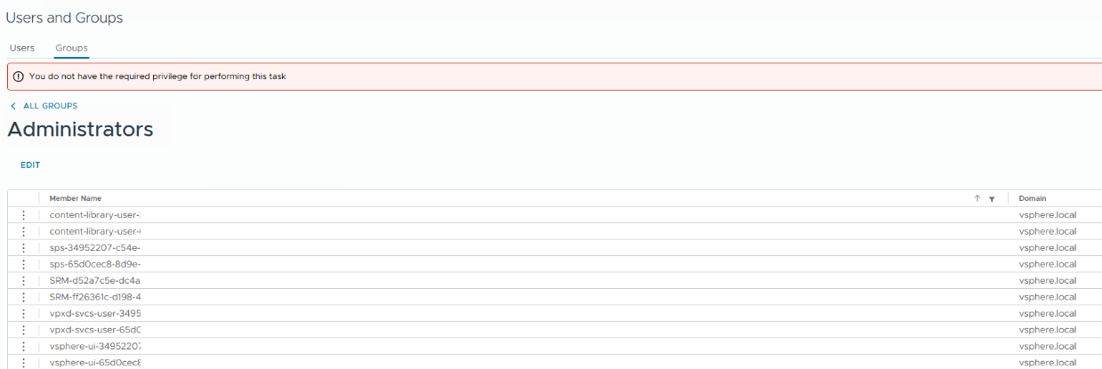

The issue is caused because the default SSO user Administrator is not a member of the Administrators group in vCenter Server.
By default, this user is expected to be part of the Administrators group. Due to this, the required administrative privileges are not available, and permission validation fails during VRMS registration.
Navigate to Administration --> Access Control --> Groups in vCenter and verify whether the Administrator user is present in the Administrators group.
The issue is resolved by restoring the required permissions for the SSO user.
  1. Access the vCenter Server using a user account with administrative privileges.
  2. Navigate to:
  3. Open the Administrators group.
  4. Add the user Administrator back to the group.
  5. Changes are saved.
  6. Retry the vSphere Replication configuration.
After the user is added back to the Administrators group, the required permissions are restored, and VRMS registration completes successfully without errors.
