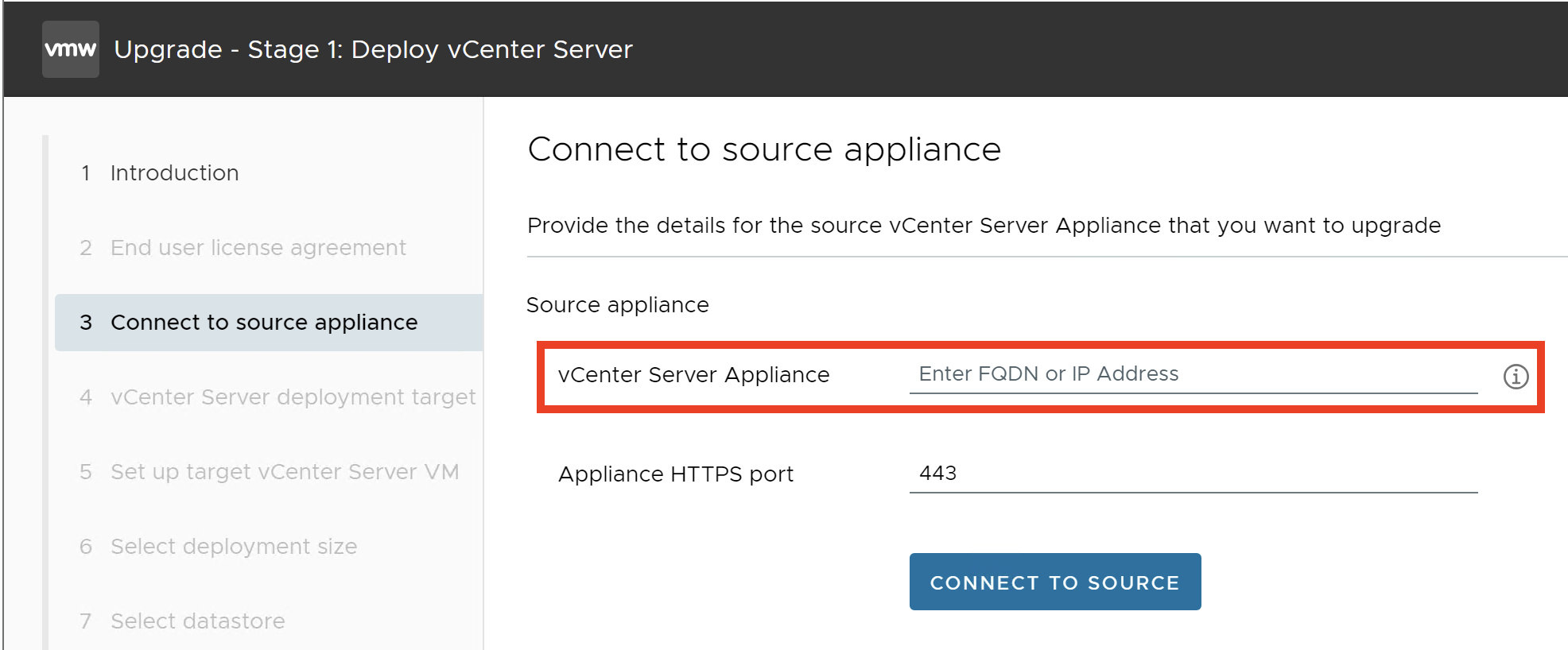

  • The vCenter Server 7.0 has been deployed using an FQDN, but an IP address was entered as source appliance in the Upgrade wizard Stage 1 Step 3 ("Connect to source appliance")

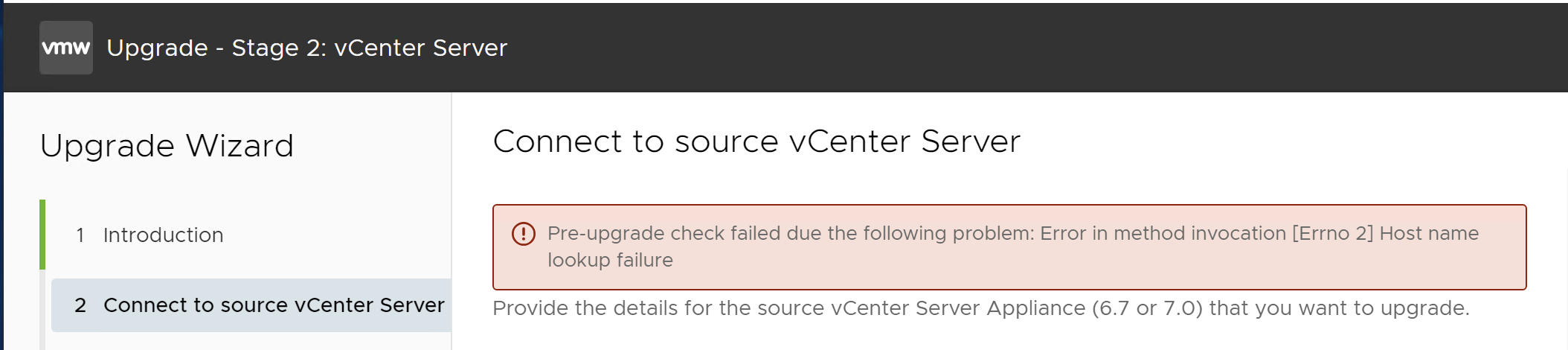

  • An error occurred during Stage 2 Step 2 (“Connect to source vCenter Server”) with the following message:
Pre-upgrade check failed due the following problem: Error in method invocation [Errno2] Host name lookup failure

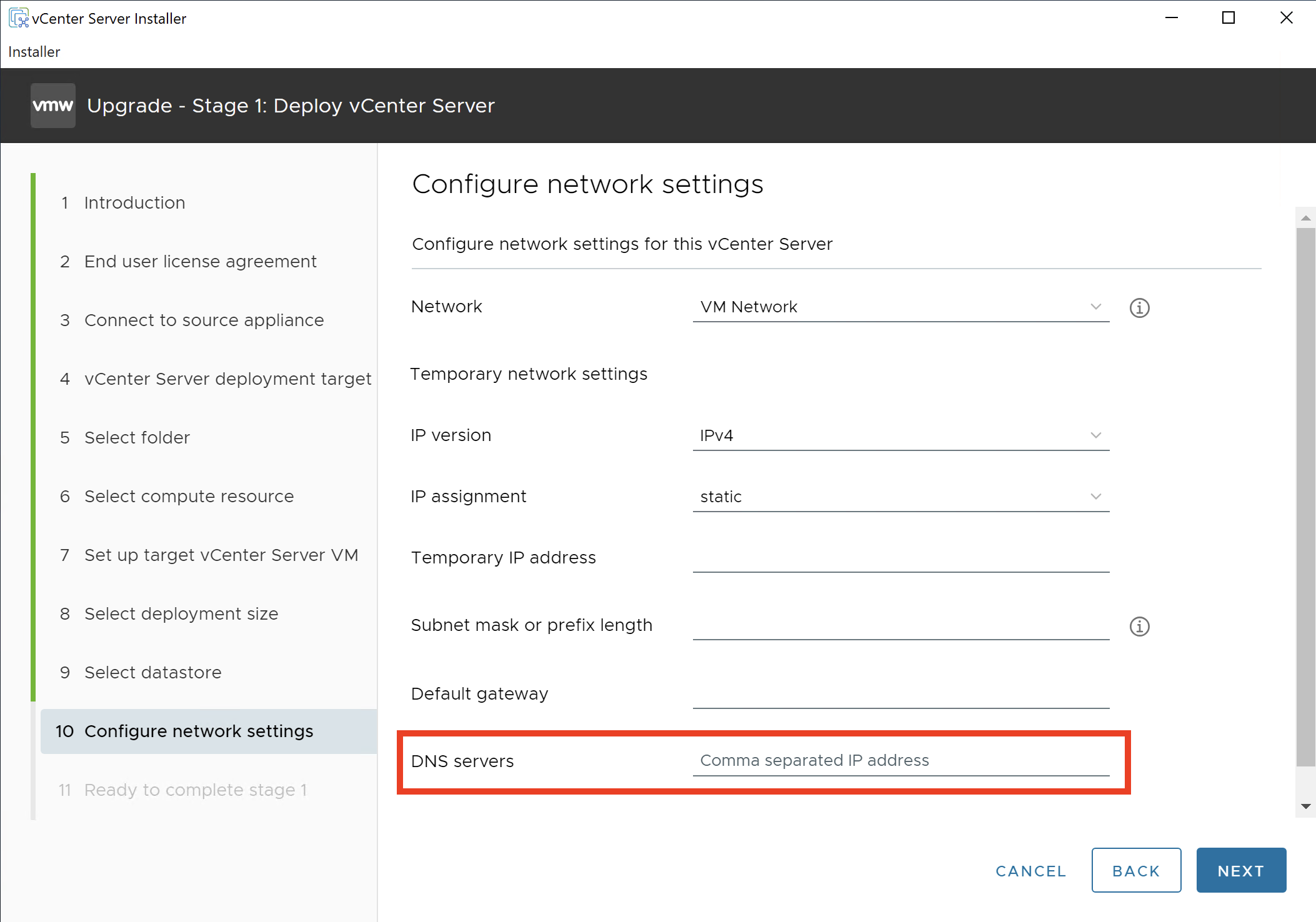

  • The Upgrade Wizard requires reverse DNS lookup, which fails if DNS servers are incorrectly configured.
For example, because the IP address entered in the “DNS servers” field is incorrect.
  • Verify the IP addresses of the configured DNS servers in /etc/resolv.conf or from the following message in /var/log/vmware/upgrade/bootstrap.log on the newly deployed vCenter Server 8.0 appliance.
YYYY-MM-DDTHH:MM:SS.###Z INFO transfer_network File '/etc/resolv.conf' has contents: # This is /run/systemd/resolve/resolv.conf managed by man:systemd-resolved(8).
# Do not edit.
# This file might be symlinked as /etc/resolv.conf. If you're looking at
# /etc/resolv.conf and seeing this text, you have followed the symlink.
# This is a dynamic resolv.conf file for connecting local clients directly to
# all known uplink DNS servers. This file lists all configured search domains.
# Third party programs should typically not access this file directly, but only
# through the symlink at /etc/resolv.conf. To manage man:resolv.conf(5) in a
# different way, replace this symlink by a static file or a different symlink.
# See man:systemd-resolved.service(8) for details about the supported modes of
# operation for /etc/resolv.conf.
nameserver 127.0.0.1
nameserver ###.###.###.###
search .
Ensure that the source vCenter Server's record is registered with the DNS server and retry with the correct DNS server IP address.
If you enter a source vCenter Server FQDN in the Upgrade Wizard Stage 1 Step 3 and the system cannot resolve that name, the following error occurs in Stage 2 Pre-upgrade check result:
Failed to connect to source appliance <Source VC FQDN> port 443: [Errorno -3] Temporary failure in name resolution
