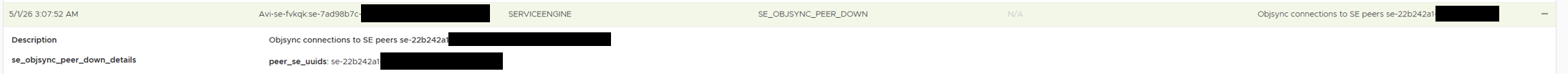

You see the following event on the controller under Operations>Events>All Events:

  • If the port 4001 is not allowed in your environment such that the Service Engines cannot communicate over this port, persistence will be impacted and an event will be generated on the controller: "SE_OBJSYNC_PEER_DOWN".
