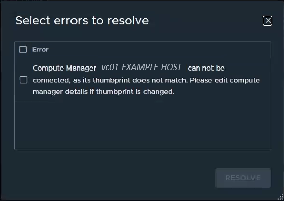

  • Clicking on the "Down" message shows the following message: Compute Manager ... can not be connected, as its thumbprint does not match
