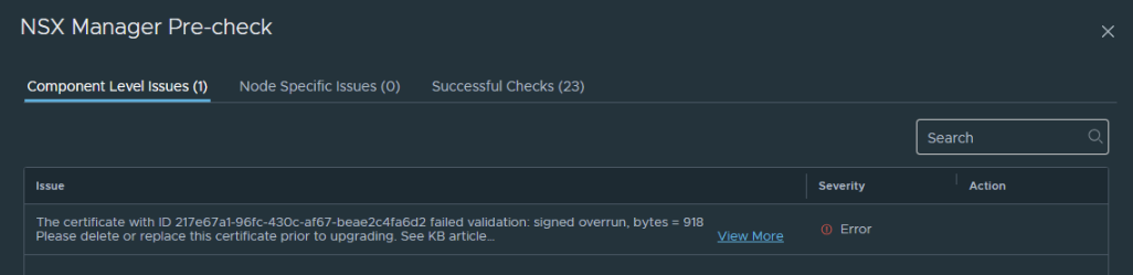

  • During VMware NSX upgrade readiness checks, the process fails at the Certificate Validity Checks stage. The pre-check identifies a specific certificate that prevents the upgrade from proceeding.
  • In the NSX Manager UI or upgrade logs, you see the following error message:
    The certificate with ID <UUID> failed validation: signed overrun, bytes = <Value> Please delete or replace this certificate prior to upgrading.
  • The issue is typically visible under the MP (Management Plane) component type with error code 30460.
    See reference error screenshot:
  • Certificate in question is a CA Signed Certificate.
  • Log evidence found in desired_state_manager.json confirms the validation failure and identified the specific certificate display_name
  • VMware NSX Version: 4.x
This issue occurs when a certificate imported into the NSX Manager has an incorrect format or structural anomaly (specifically a "signed overrun" error during the validation parse), which prevents the upgrade utility from verifying the certificate chain or validity.
