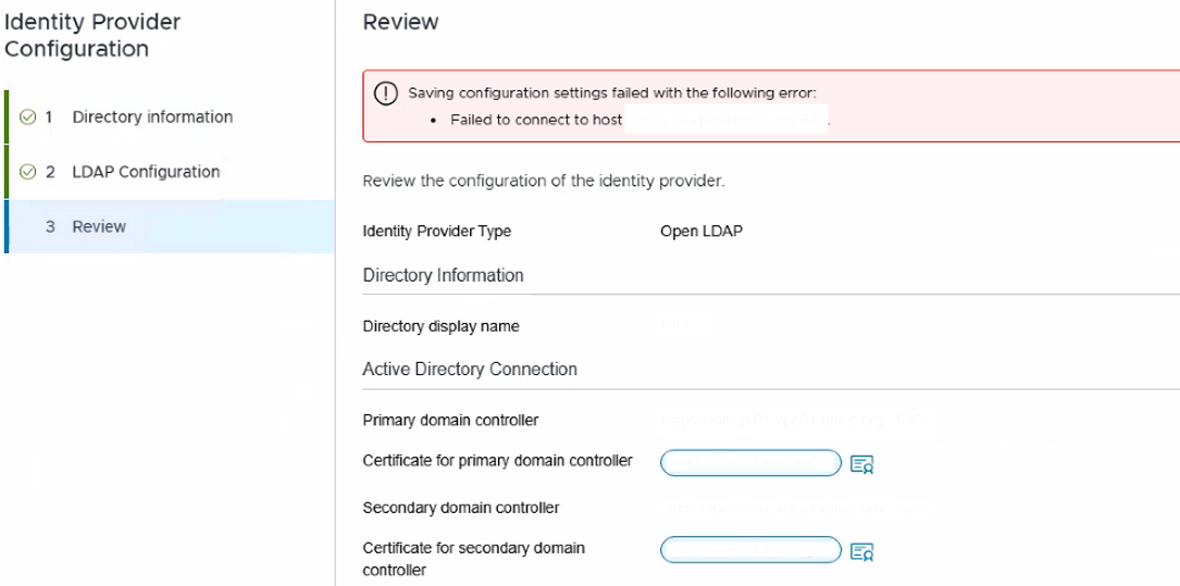

  • When attempting to configure an Identity Provider in the VCF Operations UI, the process fails at the "Review" stage.
    Saving configuration settings failed with the following error: Failed to connect to host <domain_controller:port>
