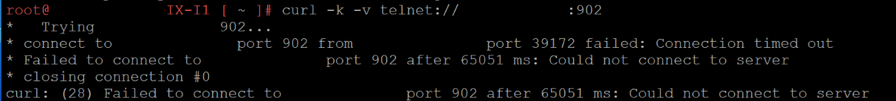

  • Below is CURL result from SOURCE IX TO SOURCE ESX host Replication interface:

    <timestamps> UTC info hbrsrv[01629] [Originator@6876 sub=Libs groupID=FRID-########-####-####-####-b76f42edeb8a opID=hsl-17f2f275] Cnx_Connect: Error message: Failed to connect to server <IP>:902
VMware HCX
Network connectivity is blocked from the Source HCX Interconnect Appliance (IX) to the destination ESXi host on TCP port 902.
Port 902 is required for HCX Reverse Recovery operations, and network tests (e.g., NMAP and CURL) indicate a connectivity failure.
