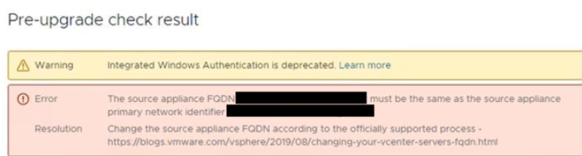

When upgrading vCenter Server from version 7.x to 8.x, the Phase 2 pre-upgrade check fails with the following error:
Error: The source appliance FQDN <VC_FQDN> must be the same as the source appliance primary network identifier <VC_PNID>
Example: The source appliance FQDN VCENTER.example.com must be the same as the source appliance primary network identifier vcenter.example.com
