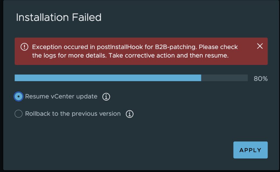

  • The vCenter patch failed with the following error: “Installation Failed – Exception occurred in postInstallHook for B2B-patching. Please check the logs for more details. Take corrective action and then resume.”

This issue is caused by a broken Security Token Service (STS) pipeline, often triggered by expired or invalid STS signing certificates, or stale machine account credentials and passwords.
Note: Take a snapshot without memory of the standalone vCenter server. If in linked mode, take powered-off snapshots of all vCenter servers in the same Single Sign-On (SSO) domain.
  1. Select Rollback to the previous version.
  2. Run the vCert utility.
  3. Select Option 3: Manage Certificates.
  4. Select Option 8: STS Signing Certificates.
Once the STS certificate is replaced, restart the update.
