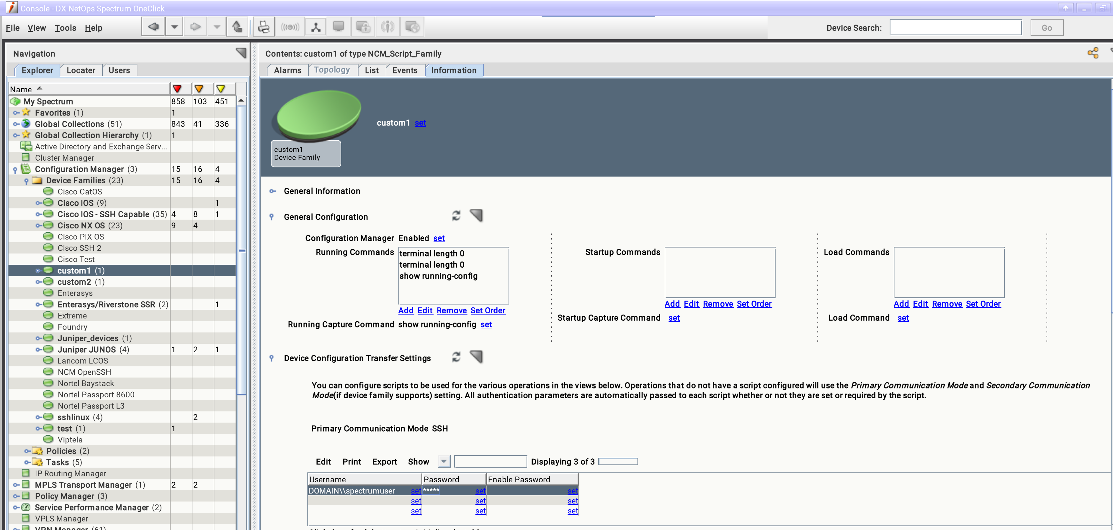

 Network Configuration Manager (NCM) was unable to capture host configurations after the username was changed to a domain-based format (Domain\user). The capture failed with a login error in the logs: "Error [252] Host [IP_ADDRESS]: Login has failed. Didn't see device prompt as expected."
Version 24.x 25.x
The NCM Perl scripts treated the single backslash in the domain username as an escape character rather than a literal character, leading to authentication failure.

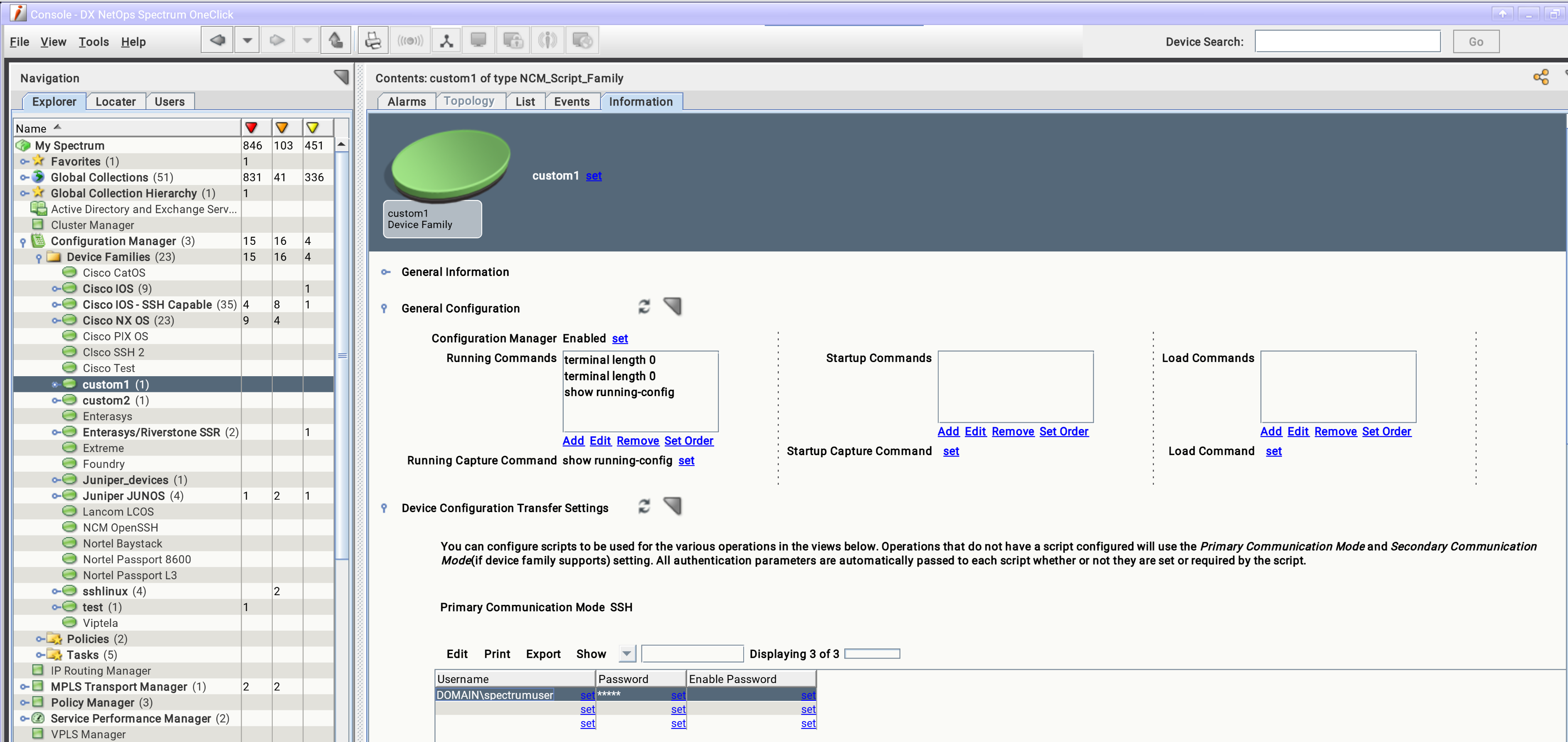

The username configuration was updated to use a double backslash (domain\\spectrumuser) to ensure the backslash was treated as a literal character
User : [DOMAIN]\\spectrumuser
