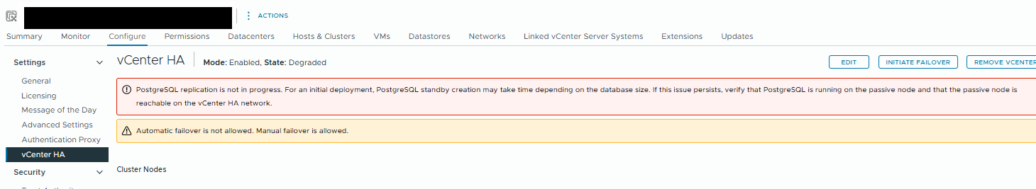

When enabling VCHA, the error message appears:
  • "PostgreSQL replication is not in progress. For an initial deployment, PostgreSQL standby creation may take time depending on the database size. If this issue persists, verify that PostgreSQL is running on the passive node and that the passive node is reachable on the vCenter HA network."
