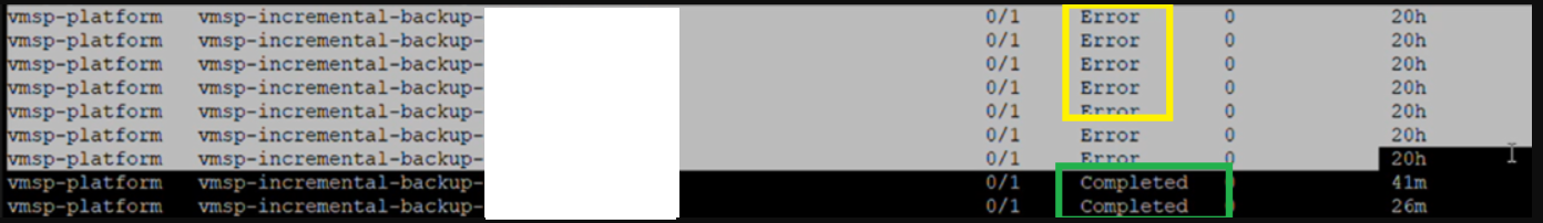

  3. Search for pods associated with the restoration or incremental backup tasks:
    kubectl get pods -A | grep -i restore
    kubectl get pods -A | grep vmsp-incremental-backup
    Example:
    Note: Validate the timestamp of the pods. An "Error" state on an old pod may be superseded by a more recent "Completed" pod.
