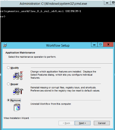

Procedure 1: Uninstall Workflow
  1. Navigate to the installation directory where the Workflow MSI is located (usually under <installDrive>\program files\Altiris\Symantec installation manager\installs).
  2. Open a Command Prompt and run the correct version of the MSI using the following parameter:
    msiexec.exe symantec_workflow_8_x_x64.msi SKIPAIM=1
    For example:
    msiexec.exe symantec_workflow_8_6_ru2_x64.msi SKIPAIM=1
  3. In the Workflow Setup dialog, select the Remove option.
  4. Follow the prompts to complete the process and verify the component has been removed.

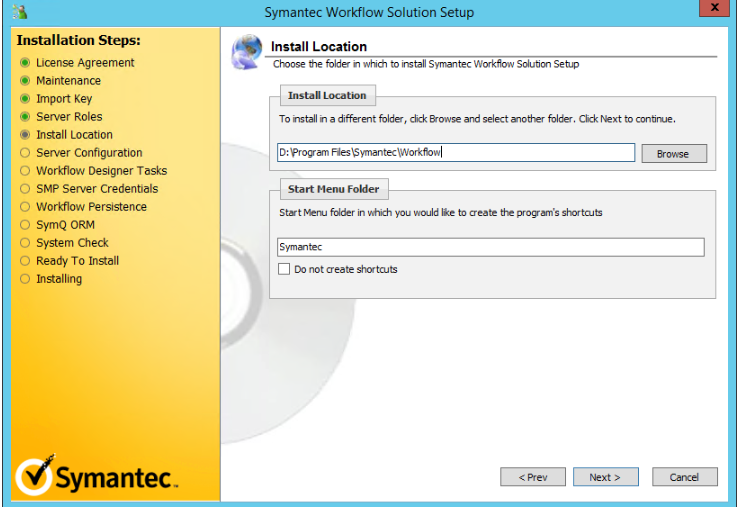

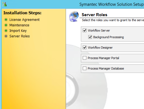

Procedure 2: Install / Reinstall Workflow
  1. Locate and execute the correct version of the Workflow MSI for your current ITMS RU level.
    In this example, the current version for the SMP Server is 8.6 RU2:
    msiexec.exe /i symantec_workflow_8_6_ru2_x64.msi SKIPAIM=1
  2. Complete the installation wizard.
  3. Validate that the SWFSVR service is present and can start successfully.
    Services.msc → Symantec Workflow Server (SWFSVR)
  4. Verify that Workflow pages are now accessible within the SMP Console.

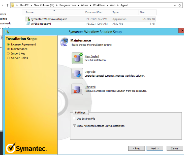

Alternative Recovery Method
If the MSI installation fails to resolve the issue, you may use the standalone setup utility:
  1. Locate the Symantec.Workflow.Setup.exe file. Usually under <Install Dir>\Program Files\Altiris\Workflow\Web\Agent\Symantec.Workflow.Setup.exe
  2. Right-click the file and select Run as Administrator to initiate a manual repair or reinstall.
    Note: This method may fail if system state is inconsistent
